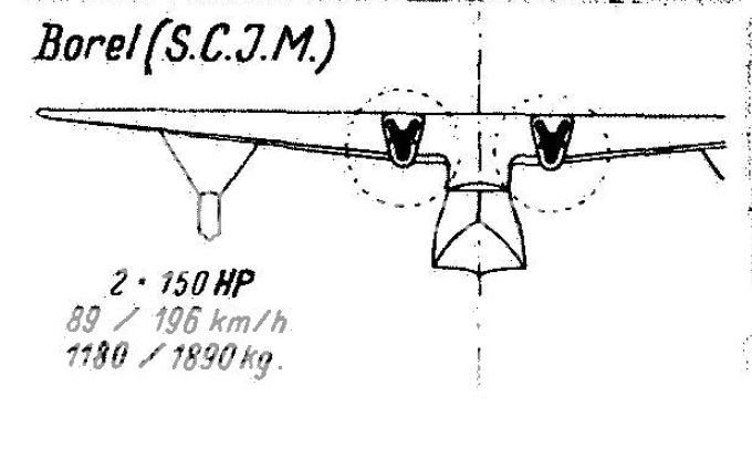

MessageSujet: Re: Avions Borel   Avions Borel EmptyJeu 25 Avr 2013 - 19:21
Thank you Mrac-91;
and this Borel flying boat project,I found it in NASA report,and my dear Vigair said;
it was mentioned in Trait d'Union issue 202.
Avions Borel Borelflyingboat_zps6fbff4f0

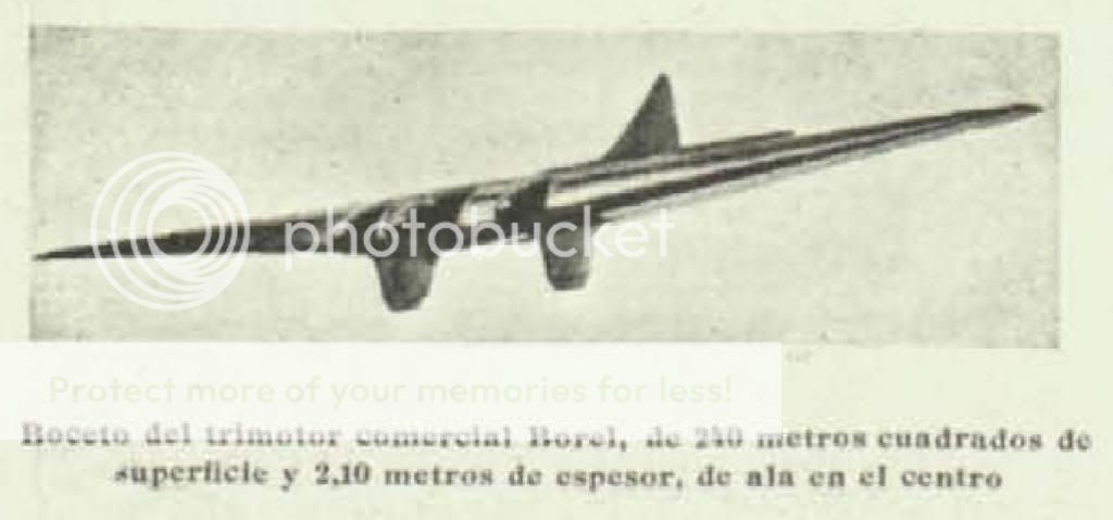

MessageSujet: Re: Avions Borel   Avions Borel EmptySam 12 Avr 2014 - 0:52
Hi,
here is the Borel three engined blended-wing medium transport aircraft,fitted with fixed
landing gear,project of 1924.
http://www.secretprojects.co.uk/forum/index.php/topic,7118.msg210501.html#msg210501
Avions Borel Borel_trimoteur_Aeacuterea_011_p17_zpscf64180c
Avions Borel Borel_trimoteur_Aeacuterea_011_p16_zpsb4aa448c
